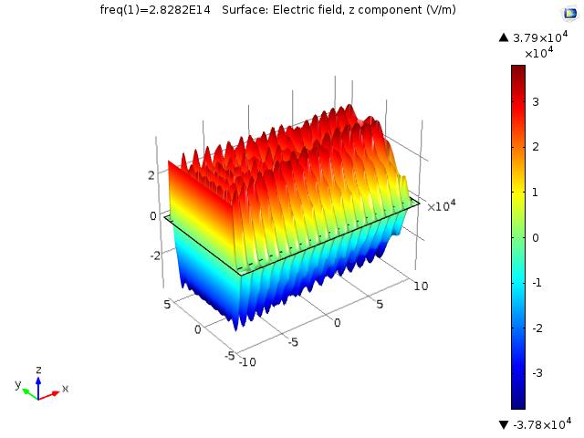

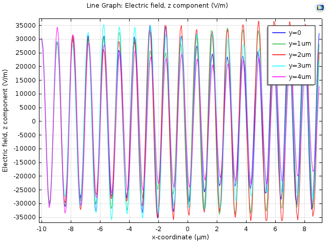

Hi Ivar,
I still have trouble on defining a plane wave in COMSOL 2D model. I define the incident plane wave in PORT on the left boundary. And PMLs are used for top, bottom and right boundaries. However, the simulation result shows that the plane wave suffers much distortion as propagating even in the uniform space.
I am wondering if COMSOL regards my definition of plane wave as a finite aperture, so that I fail to get the perfect plane wave.
Can you explain the plane wave distortion in the attachment, or offer me any advice of plane wave excitation?

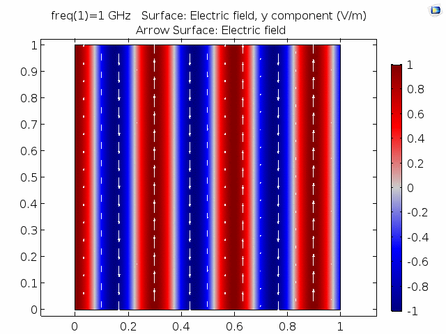

If your objective is to generate a plane wave for the purpose of studying scattering from a finite-extent object, use the scattered field formulation. For example, In a 2D problem, set for Electromagnetic Waves, Frequency Domain, under the Settings tab, you will see "Solve for:" and the default setting is "Full Field." Change that to "Scattered Field."
After you do that, you can set the "Background electric field". Here is where you will specify your plane wave. You will see boxes in which you can specify the x, y, and z components of Eb. Let's consider a specific example. For a plane wave traveling in the +x direction, with wavenumber k0 (which Comsol will compute later, from your still-to-be-specified value of the frequency), and with a polarization (i.e., the direction of Eb) aligned along the y direction, you would specify Eb as follows:
Eb, x component: 0
Eb, y component: exp(-j*emw.k0*x)
Eb, z component: 0
I hope now you can get the idea of how to specify other orientations and polarizations of plane waves. Next, let's discuss the boundary conditions. First, specify "scattering boundary conditions" on the surfaces perpendicular to k. Think of these as the surfaces from which the wave is launched and to which the wave is received/dumped. Second, specify either PEC or PMC conditions for the surfaces along which the wave travels tangentially, as appropriate. For the above planewave specific example, if you have a square in 2D, then the vertical boundaries of the square should be scattering bcs, while the horizontal boundaries would be PEC (since Eb is normal to them). This eliminates the distortion in the wave, that was causing trouble for you.
I've attached an animated .gif showing the resulting wave, which is very clean.
Eb, x component: 0
Eb, z component: 0
