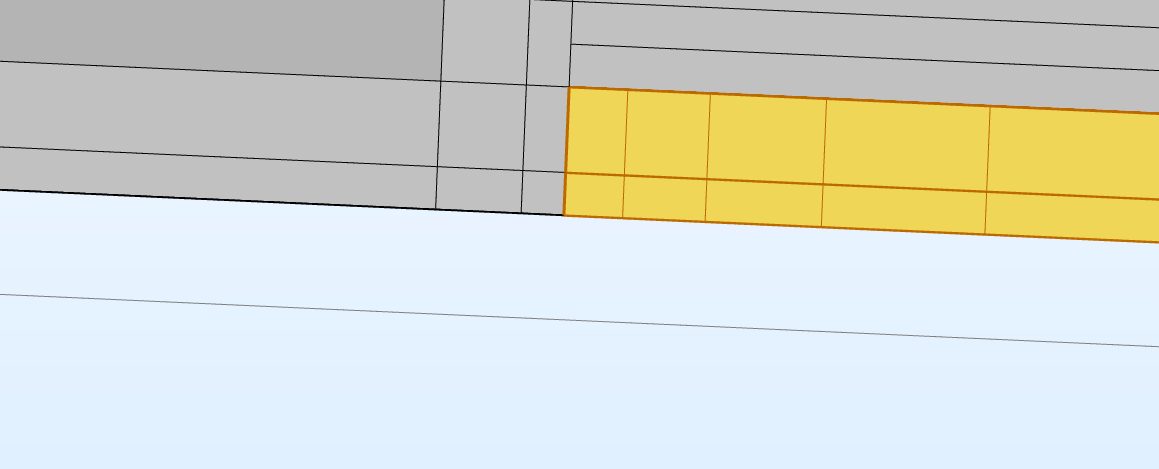

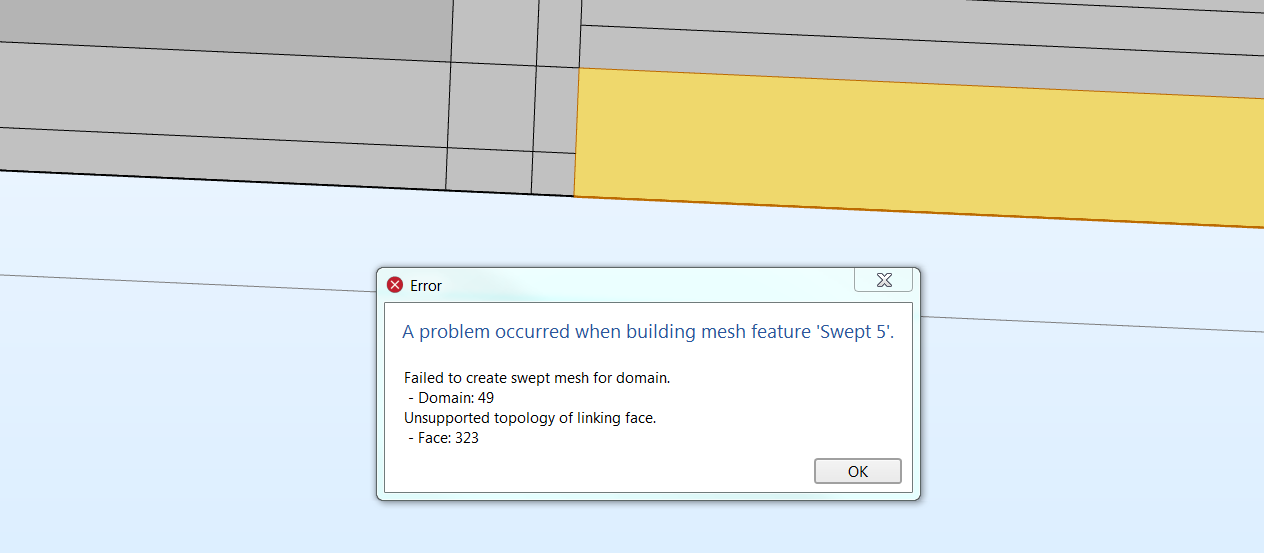

I am currently having issues linking source faces to its destination face in the swept mesh. The Geometry I am using has a thin device design, and have successfully meshed the source face. When doing the sweep, a side face is currently sounding off an "Unsupported topology of linking face" error even though it is a simple extrude.
I am unsure how to debug this current issue to remove the problem as the geometry is a flat face that should have no topological complexity. The file size is larger than 5 MB and even through optimization I cannot attach it.

hi Jeremy,
I don't know if you still need the answer. But I think you shode partition the domain based on the neighbor domains. I have attached an example.
Bests, Mohammad
