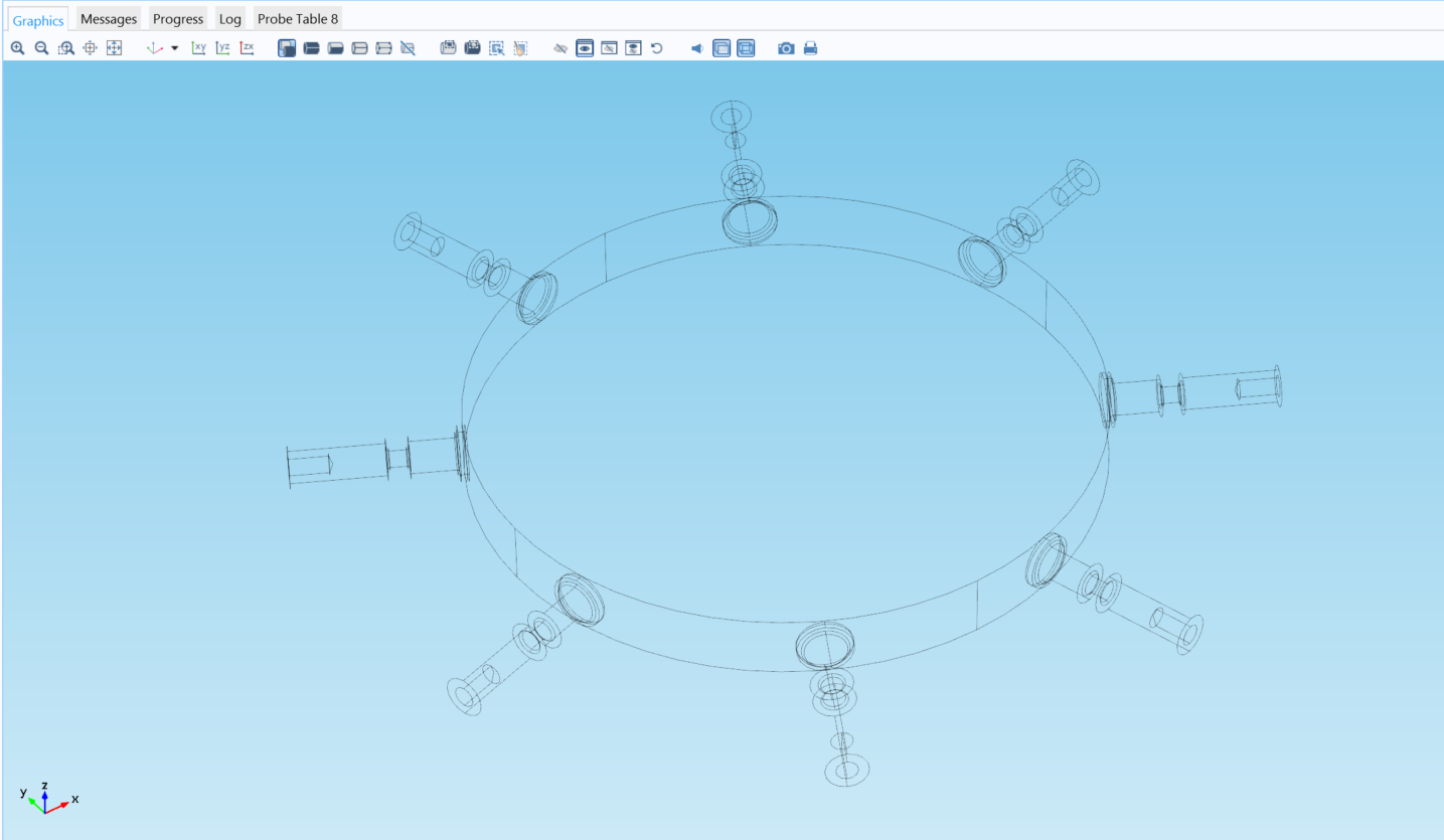

Divide the surface of a cylinder with height of 8mm and radius 80mm into 8 equal parts(45 degrees)
I'm working on ERT, sensitivity, on COMSOL for multiphase(water and oil) flow
I have calculated the total current density of water and i need to calculate the total current density of oil(mix). Dividing the this image below into 8 equal parts would help me do that.
Please how do i divide this into 8 equal parts on COMSOL bearing in mind that this division has to be on the surface only.
THANKS IN ADVANCE.

I would make a Workplane on top of the cylinder and draw 8 circle segments on it.
Lasse
