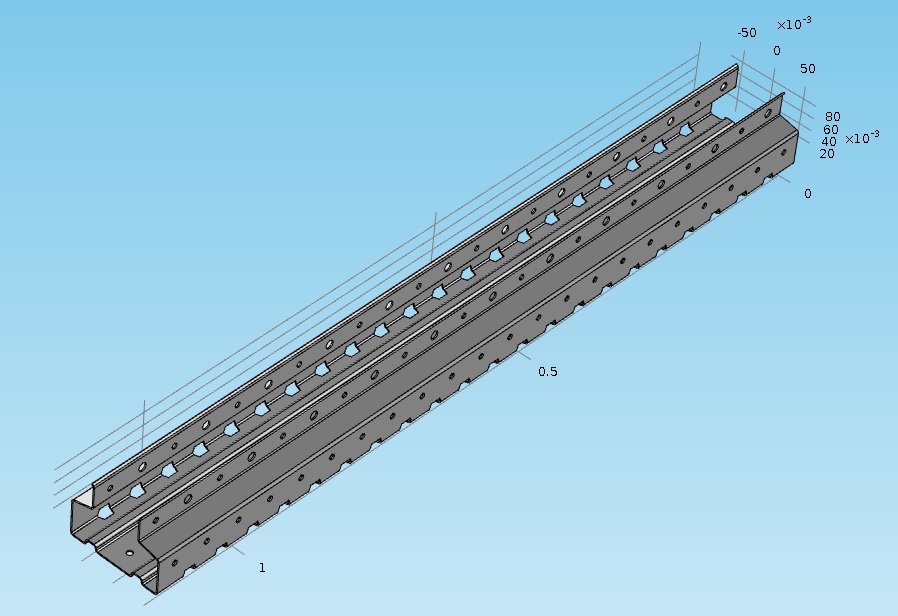

I'm modelling a thin walled element (solid geometry) and I want to mesh it with an hexahedral mesh with only one element along the thickness. I attached an image of the geometry.
The main problem is the complex geometry with circular holes and curves. I try to mesh a surface with quadrilateral element, but I can't do it on surfaces with holes.
Is it possible to mesh it with quadrilateral elements? If it is possible I can extrude them and obtain what I want.
If it is a problem I'll work with a triangular mesh.

I would expect that with the right settings it would be feasible to mesh the side (inner or outer) surface and sweep it (As opposed to meshing either of the two cross-section boundaries and sweeping that along).
But it's hard to say anything more specific without access to your .mph file. If you could post it, Discussion Forum readers may be able to help further.
I would expect that with the right settings it would be feasible to mesh the side (inner or outer) surface and sweep it (As opposed to meshing either of the two cross-section boundaries and sweeping that along). But it's hard to say anything more specific without access to your .mph file. If you could post it, Discussion Forum readers may be able to help further. Best, Jeff
