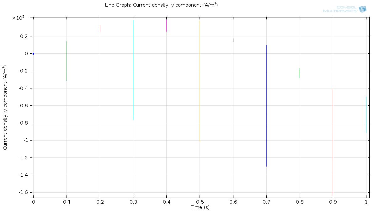

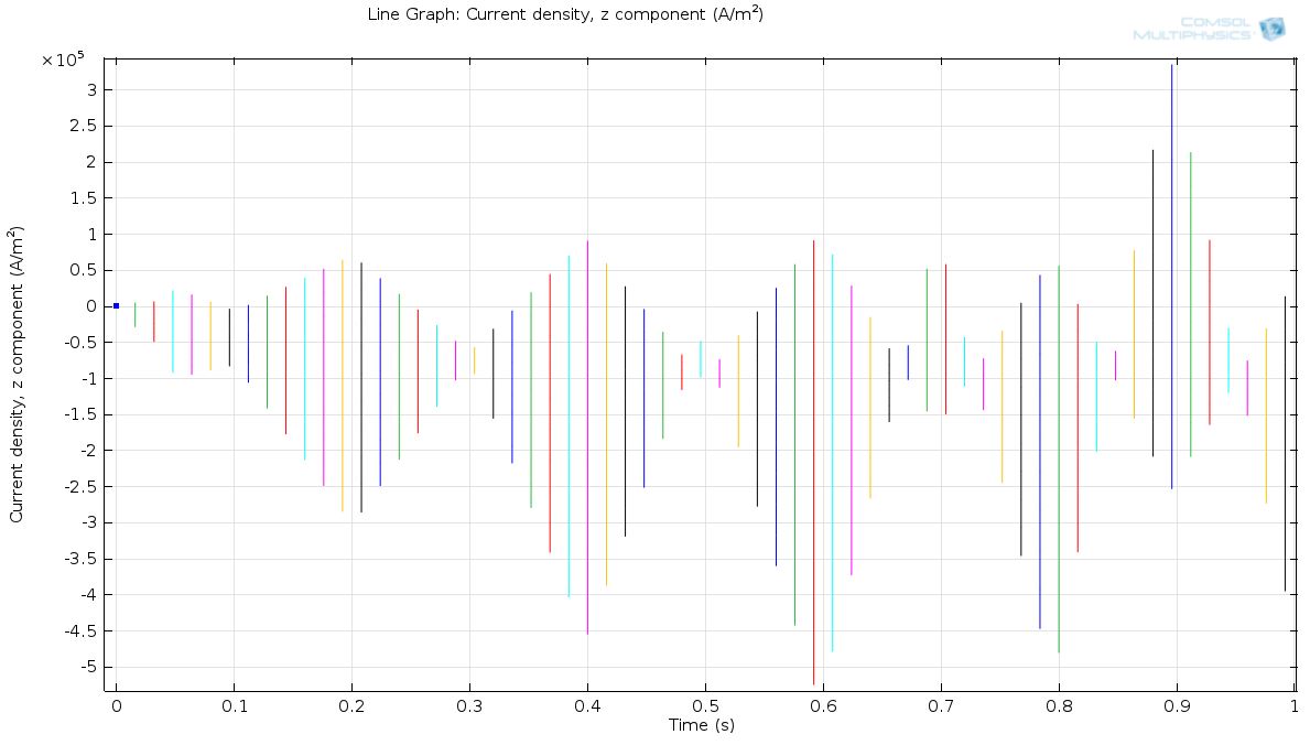

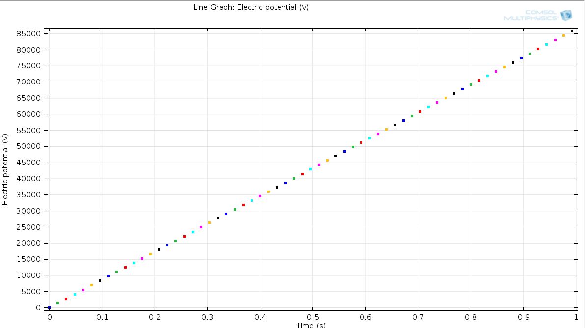

I analyzed a model using Time-dependent solver and for the time: range (0, 0.016,1). The model is consisted of different layers with different conductivity and permittivity and a Terminal with an AC current (square waveform, Amplitude:4.4 mA, angular frequency:377Hz ) is applied on top of the layers. When I click on the slice plot the amount of Electric Potential is equal to 14V. But when I plot Line Graph the value of electric potential for the same edge is about KV!!!!? Another question is that why do we have such a current density the same as the attached figure.Could somebody help me to understand the difference? Is there any document about analyzing such the plots?

Why we have negative current density here? I do not know if there is any problem with my simulation?
I would be grateful if someone help me.
The best,
Why we have negative current density here? I do not know if there is any problem with my simulation? I would be grateful if someone help me. The best,

with a time step of 0.016 s you cannot resolve the 377 Hz stimulus. And your plots are strange. What are all the different colors representing?
Cheers
Edgar
Hi, with a time step of 0.016 s you cannot resolve the 377 Hz stimulus. And your plots are strange. What are all the different colors representing? Cheers Edgar -- Edgar J. Kaiser http://www.emphys.com

I thought that different colors stand for various time. Since when I change the step sizes to larger values (range (0,0.1,1)) I get to another plot that contains less vertical lines, the attached figure. When I want to plot the current density the only possibility to choose are edges!!! How can we select a surface when we plot current density?
