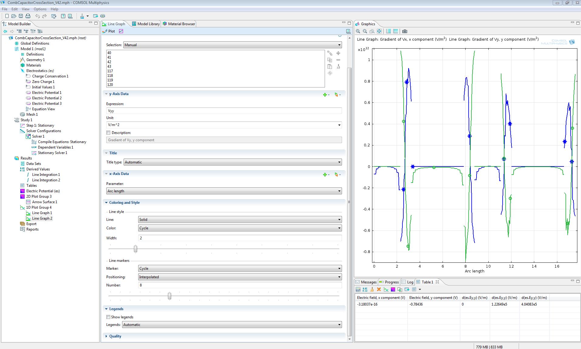

in my 4.3.a I get non zero values (where you seem to get "0", strange), now you need to take the side parts too, ideally the full finger turn
But on the other side if you plot Vxx and Vyy along the entire loop around your "finger section" you get quite some spikes that will give you rather large errors see below.
I would propose to increase the discretization (turn on in the view mode) for V
One advise: use rather GND for the "0V" and a "Terminal" at 1V for the others BC's (instead of the Electric potential, as you have a scalar and not a field), then you get lumped parameters to compare already made up for you. But it should not change anything for your force calculation. And as you have only 1 domain, you cannot get the "ES Domain Force Calculation" defined
Do not forget these values are for a 1 meter loooong device (along Z)
Hi in my 4.3.a I get non zero values (where you seem to get "0", strange), now you need to take the side parts too, ideally the full finger turn But on the other side if you plot Vxx and Vyy along the entire loop around your "finger section" you get quite some spikes that will give you rather large errors see below. I would propose to increase the discretization (turn on in the view mode) for V One advise: use rather GND for the "0V" and a "Terminal" at 1V for the others BC's (instead of the Electric potential, as you have a scalar and not a field), then you get lumped parameters to compare already made up for you. But it should not change anything for your force calculation. And as you have only 1 domain, you cannot get the "ES Domain Force Calculation" defined Do not forget these values are for a 1 meter loooong device (along Z) -- Good luck Ivar
