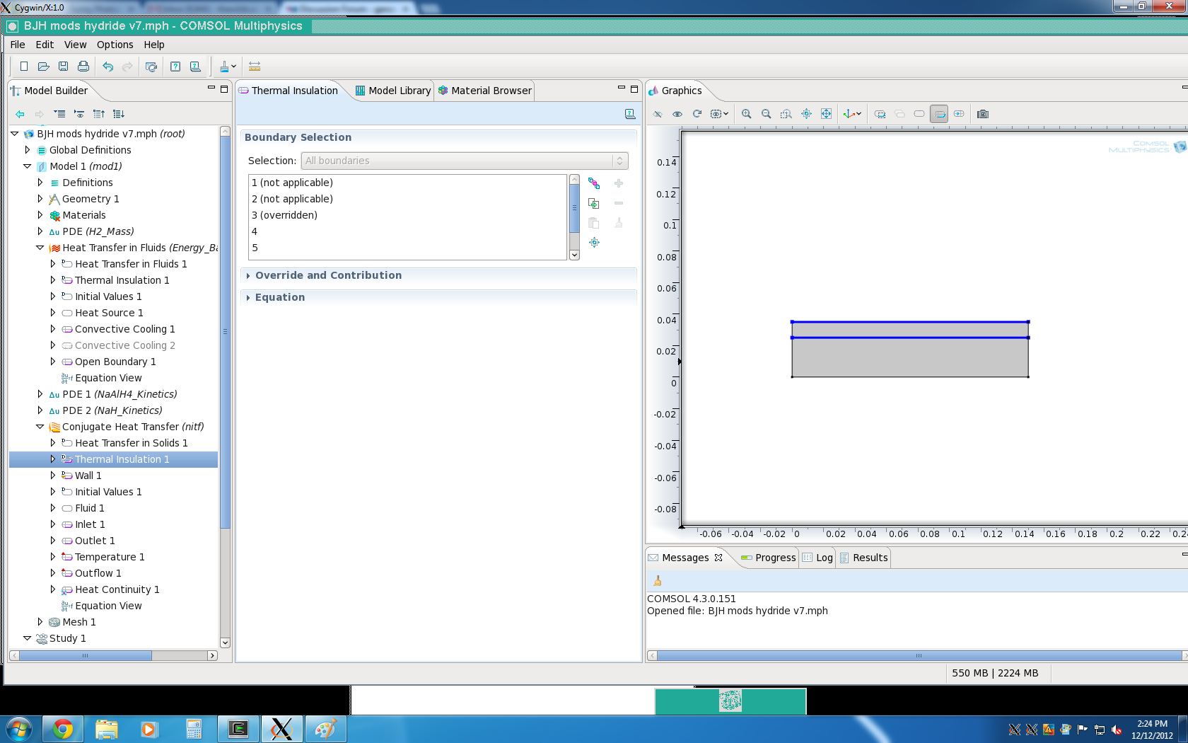

I am quite sure that each portion is assigned to the proper domain. Where I am stuck on is the fact that the Thermal Insulation BC is automatically assigned to the common boundary. As I understood it is that this should automatically be assigned as an interior boundary but it has not worked that way.
I have no idea about how to go into "assembly mode" and manually manipulate the equations. Is there a BC that I can choose from the menu that will couple these two domains or do I have to delve into some menu to find the option to join them up?

Thermal insulation is applied by default to all external boundaries of your common domains, so its normal that the "internal boundary" is flagged by default "D" as thermal isolation. Normally if you define manually the link between your two physics you will add a given BC to your common boundary, then normally the Default Thermal isolation node will flag this boundary as "overriden", as for your boundary 2 in your HT case, this is the case if you select boundary 4 as "open Boundary" which is currently not applied to any boundary
Hi Kevin Thermal insulation is applied by default to all external boundaries of your common domains, so its normal that the "internal boundary" is flagged by default "D" as thermal isolation. Normally if you define manually the link between your two physics you will add a given BC to your common boundary, then normally the Default Thermal isolation node will flag this boundary as "overriden", as for your boundary 2 in your HT case, this is the case if you select boundary 4 as "open Boundary" which is currently not applied to any boundary -- Good luck Ivar

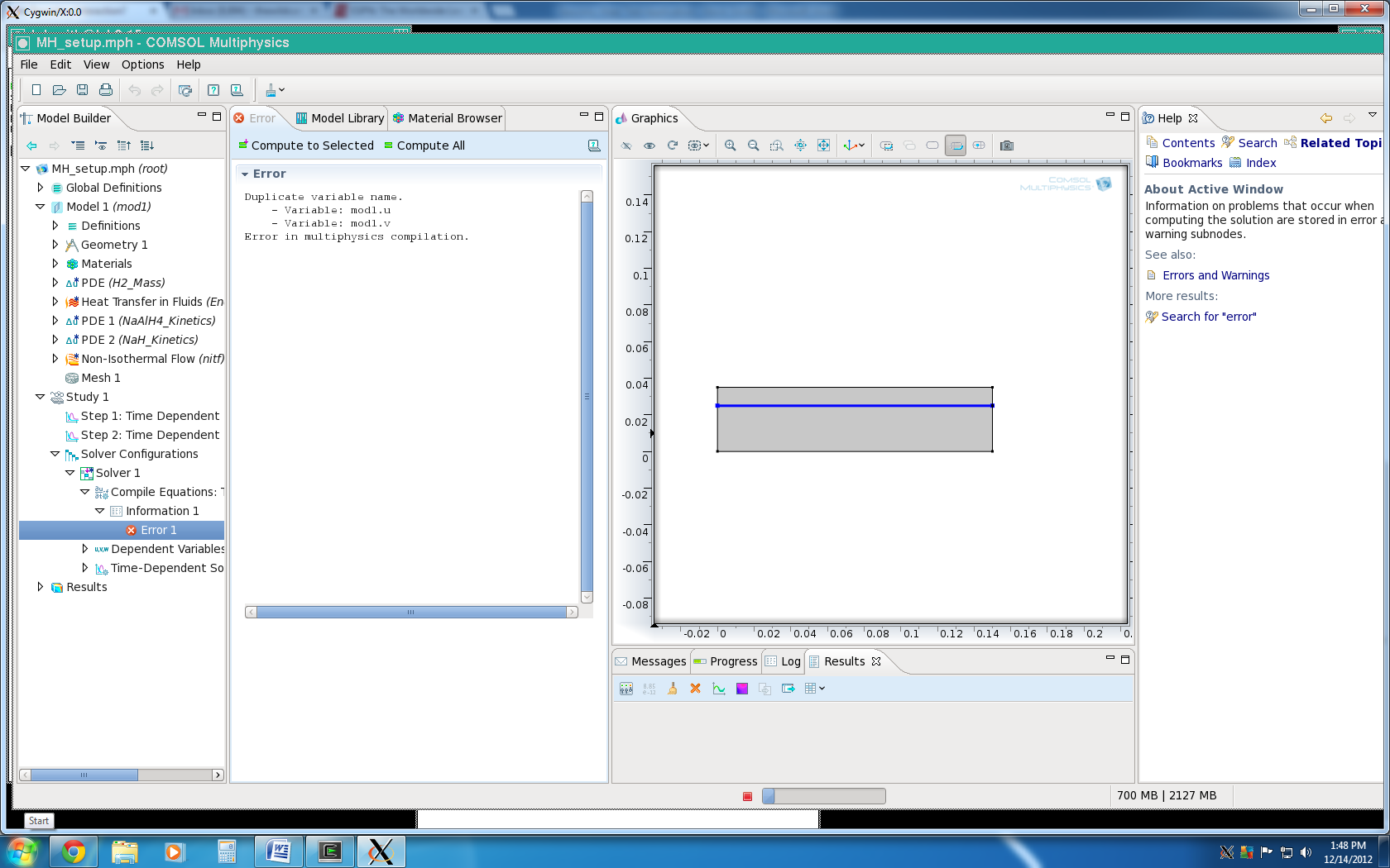

Thanks for helping me sort out that issue, but now the main error is back in force where duplicate velocities are keeping the solver from progressing. I think this may be due to the method used to program the Metal Hydride reaction, but it could also be because of the 2 N-S equations running in the separate domains. I tried separating the air portion from the metal hydride portion with different time dependent solvers, but without success. Attached is a picture of the error message I'm receiving, any advice on how to proceed?
