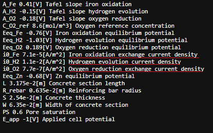

I am new to solving corrosion problems and COMSOL Multiphysics. I was try to simulate one problem and I could not fully understand the parameters in this problem https://www.comsol.fr/model/cathodic-protection-of-steel-in-reinforced-concrete-11106
How can you calculate the oxidation exchange current density and the reduction exchange current density? Given the Corrosion Current and Corrosion Potential, which formular(s) can you use the Corrosion Current to calculate the oxidation and reduction exchange current density?
