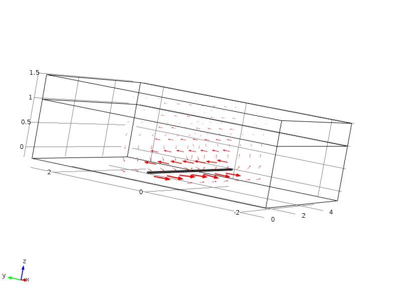

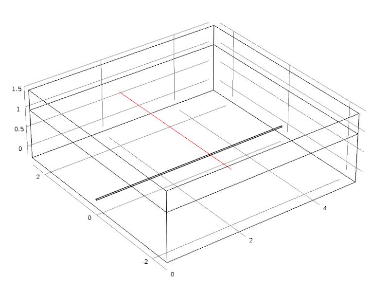

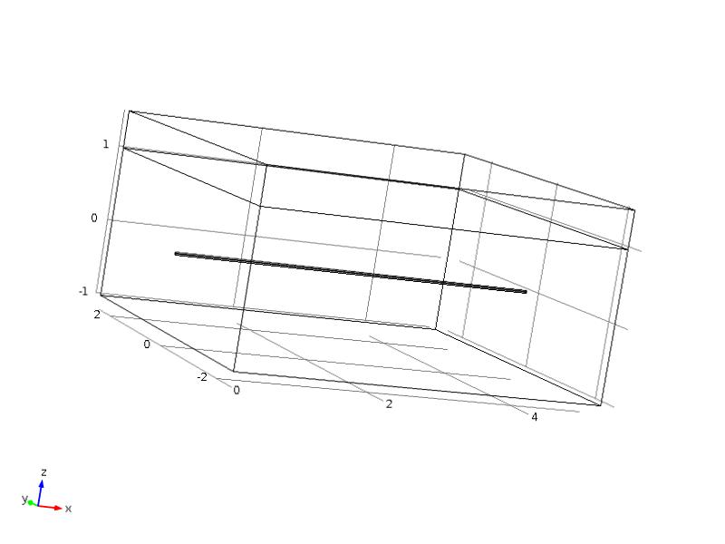

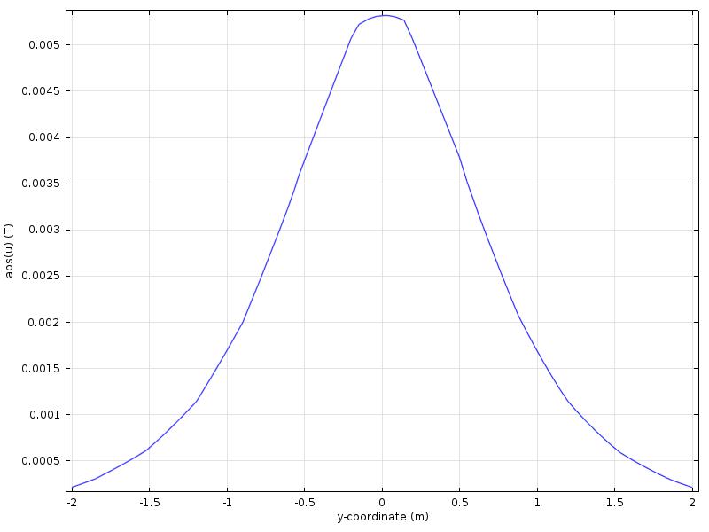

Sorry for late reply, I elaborate it more and attached some snaps of model and magentic field of 'By' component. In model, one block is used for soil while other one is air. The copper conductor length is 5m and radius is 0.019m. I applied 5 volt dc and comsole calculated 60 kA app. using current density Jx. I used two tools, they are mef and coefficient of PDC. Please someone suggest, how can I get the value of By = 0.011 T or above from this model?

I didn't plug in your numbers, but your electric wire looks too close to the lower computational boundary, which could impact your computation. I suggest you extend your computational space further downward (to provide more distance from the wire to the lower boundary) and then rerun the model. (Also, you might want to post your .mph file, not just .jpgs.)

Thank you for your response. When I read your message, I guessed that my issue has resolved. Thats true, I applied your suggested modification on model and got the required value of By component. Once again thank you Robert Koslover and Edgar J. Kaiser for your gauidance and help.
