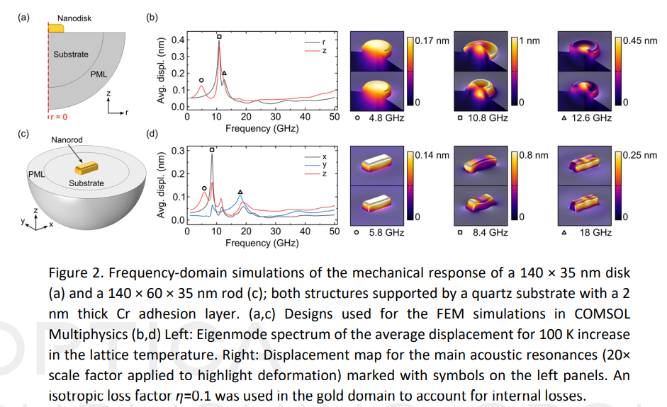

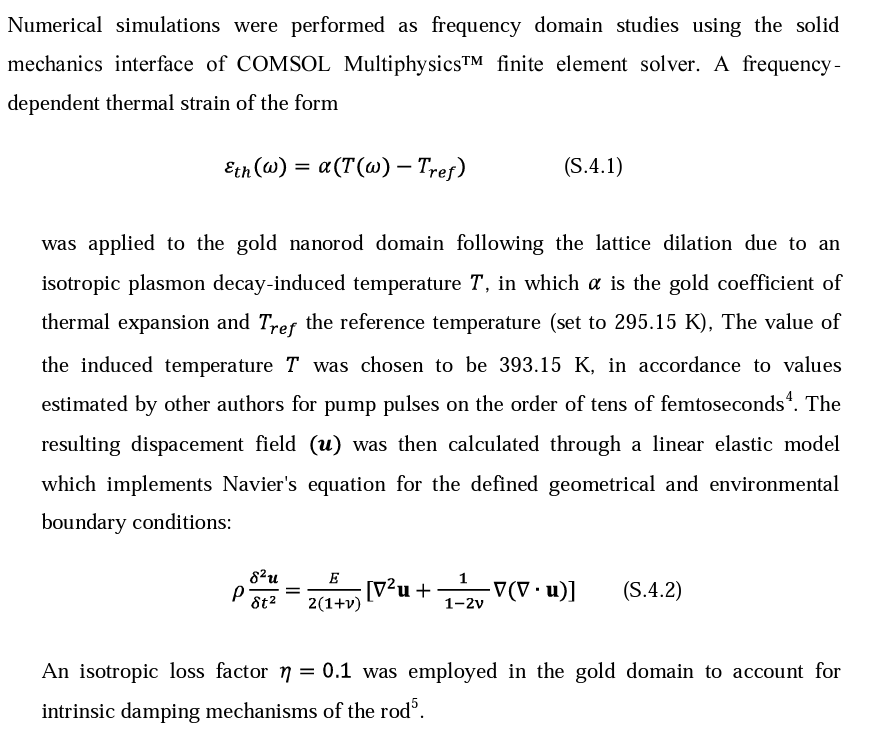

Hello, I am a newbie in COMSOL and trying to model the eigenfrequencies following some previous results from the paper.
I attached some references, and I am curious how to build this model and how to calculate the frequency-avg.displ graph.
