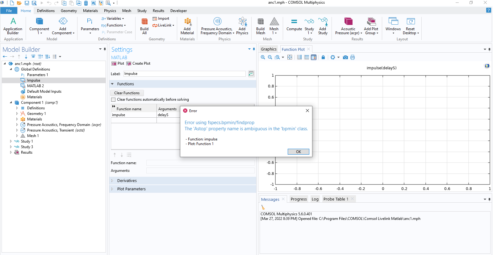

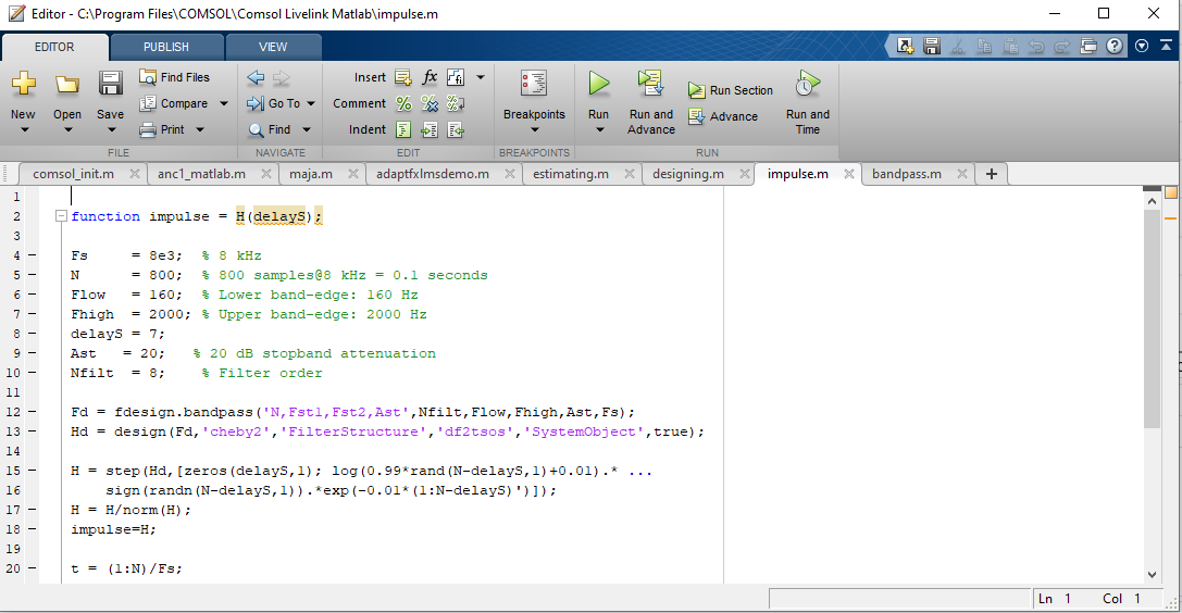

Greetings,
I am using Matlab 2015a and COMSOL Multiphysics 5.6 combined for simulation of active noise control. Actually, I am using the function for Impulse response in Matlab I am sending in attachment, and try to import it into COMSOL, but I keep getting the same error I am sending in attachment as well. My question is, is it something wrong with the function defined (which I believe is not the case, because the code goes correctly in Matlab and I even get the graph) or is it something I do wrong in COMSOL?
I would appreciate your answers. Thank you in advance! Maja
