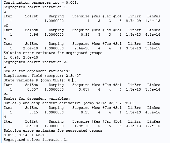

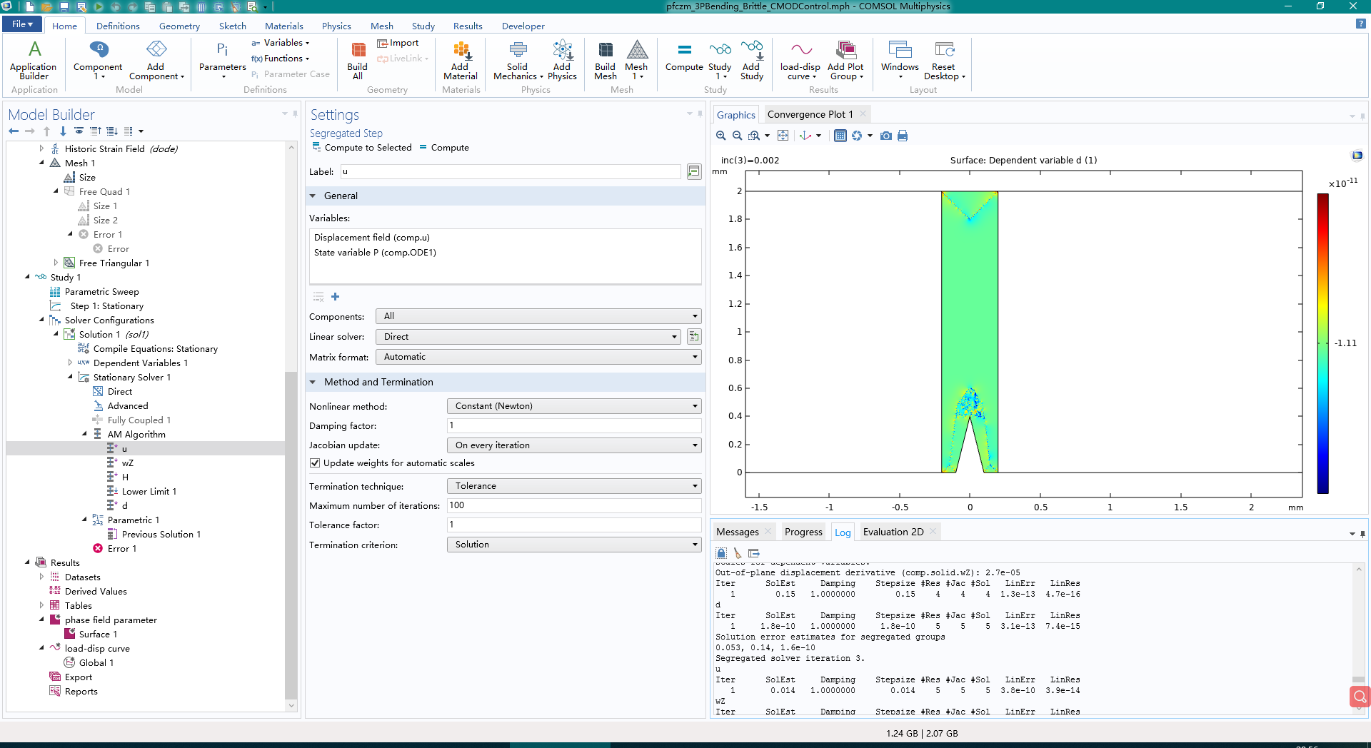

Hi! I have a multiphysics problem and I need to use segregated solver. When I has the setting as indicated in figure 1, I thought the solver will iterate the step u untill it converges. However, when I check the log, I found that the solver just perform 1 iteration then went to the next step while the relative tolerance is not obtained, as indicated in figure2. The relative tolerance for u is 1e-5. How can I set the segregated solver so that it can compute every step until reaching relative tolerance then go to the next step? Thanks.
