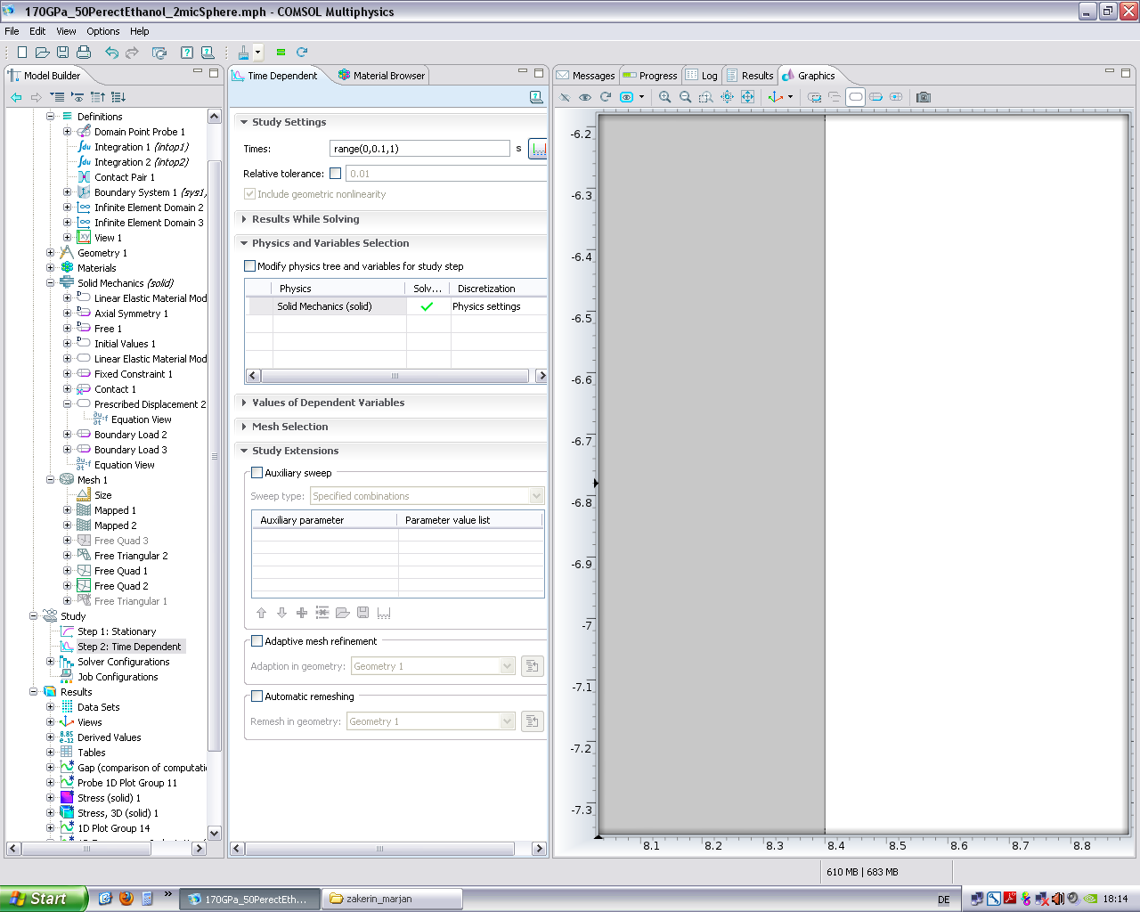

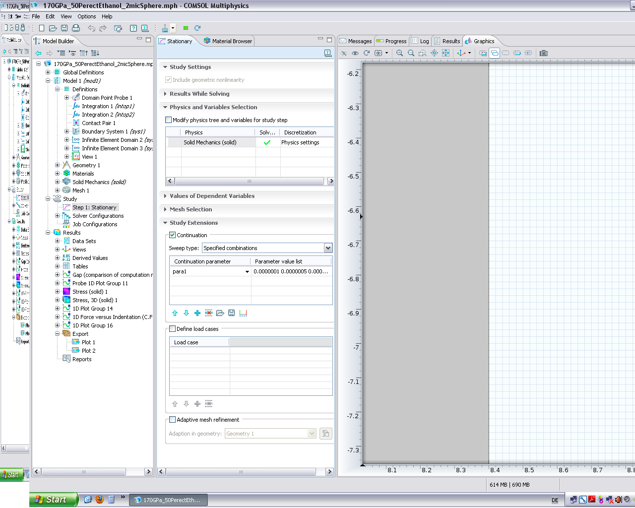

You can give values to " t" in continuation of parametric sweep. Use continuation. Please see the attached file. The second point is check that size of your mesh elements on the PMMA is 1.5 times smaller than the mesh size of your sphere. Check 2 times as well.
For penalty factor you should not have problem if you set the initial pressure about 1000 Pa or even larger.
So your simulation is 3d. Is it true that your system is only fixed at the bottom of your sample or support onto which the indenter indents and is everything else free? Then you should reconsider your model. Comsol faces problem to solve it.
What is the theory you want to compare your simulations with? I used Hertz model. As it is a model for half infinite surface, I used infinite element domains in definition part of comsol (see the attached file please) and decreased the number of mesh elements a lot. But my support is divided to several domains . The model became also very exact. It is as if you had a half space surface.

..... See the attached new file for the continuation time dependent solver
Marjan
..... See the attached new file for the continuation time dependent solver -- Marjan
