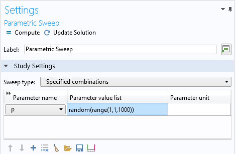

If I understand your question correct, you can just use a parametric sweep like random(range(1,1,1000)).
Se attached screenshot.

Hi, Thanks for your answer. I don't think that works in my case, because I need this set of numbers for a single simulation. If I understand correctly this will generate a random number for each simulation. Maybe more context helps: I want to make step-like variations of a quantity, with different step lengths, and the set of numbers would set the boundaries of this steps in space.

In that case, I think it is easiest to define your input using a piecewise function where the intervals are random. The table in the function can for example be populated using a model method or by importing a table in created in Excel.
