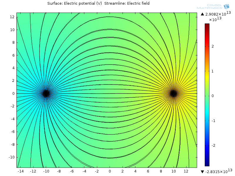

Lets say I have 2 charges (one negative and one positive) and I want to use arrow plots to show that they are attracting to each other.
I assigned a sphere as a charge and on each sphere i define charge points with positive and negative values. is that correct?
But i can't see any results!!
Do you know any examples that they defined charges on simulation?
That link and Ivar's descriptions helped me a lot and now the problem is solved.
Best
Bahareh

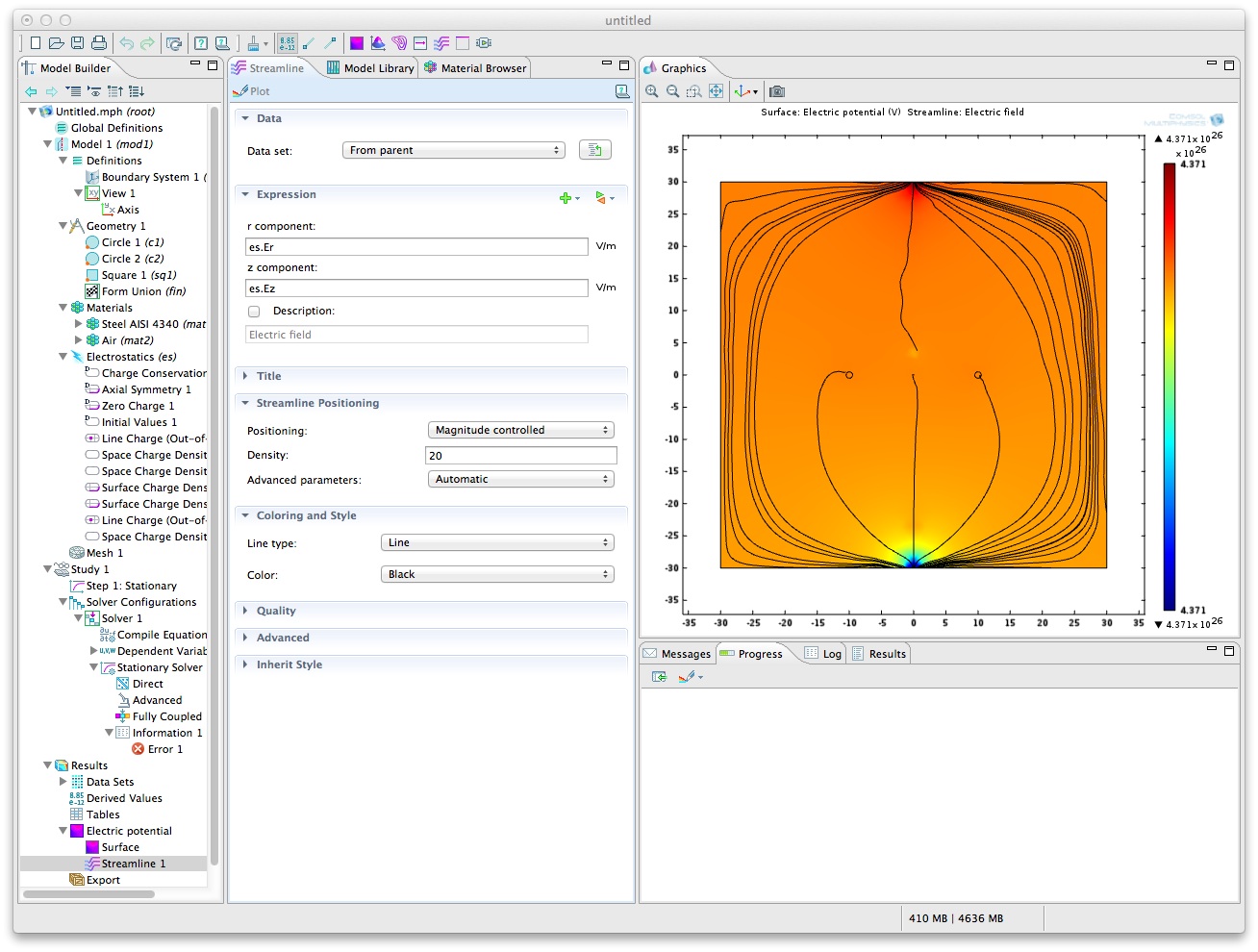

It seems like we need to specify the space between the two points as "air".
Any suggestions, please? Thank you.
indeed you need to mesh the domain around your point charges, and give them some material info, but vacuum or air is not that much dfferent, but still its not the same as a "void"
By the way in 2D a "point charge", is in fact a long vertical wire along Z charged to a given value in Coulombs per meter, since 2D is a representation of 3D with an invariant along Z the out of paper direction
you should manage, in 2D try adding under "point" the line charge and give a + and a _ sign that should work. I'm off line for a weeks time so I cannot make an example (I'm not carrying my COMSOL WS all over Europe ;)

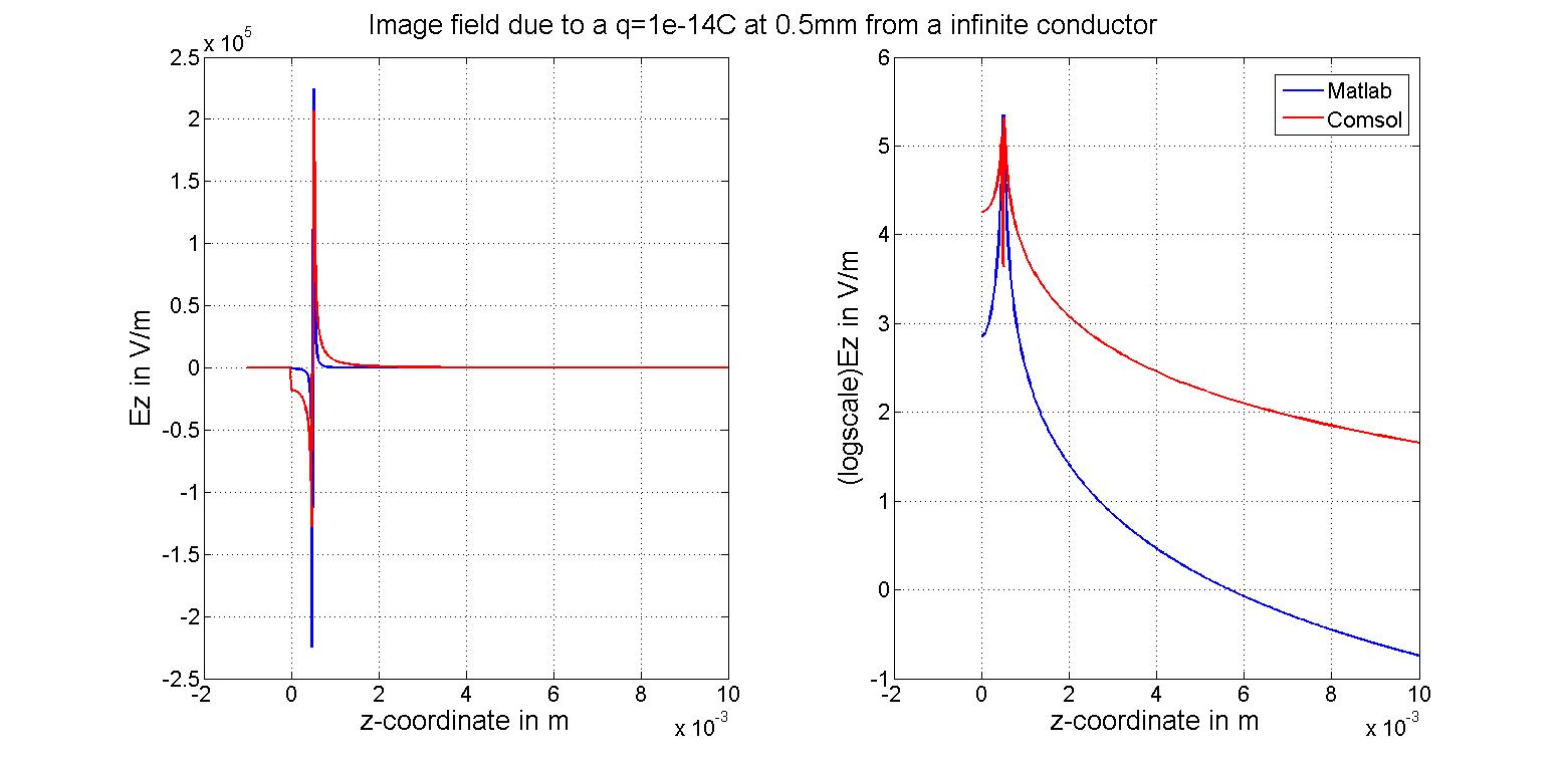

I was interested in finding image force on a charged particle near a conducting rod in comsol. Therefore as an initial check i simulated a charge near a conducting plate and compared the resulting image field to the field from analytic solution of charge on a infinite conducting plane. The results in these two case doesnt seem to match even if i increase the size of the conducting plate so that it appprox. an infinite plate.
Can you help me solve this discrepancy? Am i doing something wrong here?
Thanks,
-Emil
