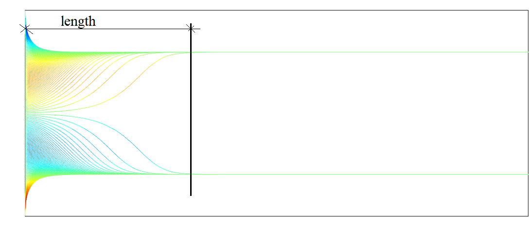

Posted 15 mag 2018, 11:59 GMT-4 Particle Tracing for Fluid Flow 0 Replies
Helo, I am working on a particle tracing case in comsol 5.2a, exactly on inertial focusing in pipe. In this problem when a neutrally bouyant particles are carried by the flow in a pipe after some time particle migrates to an equilibrium position which is 0.6 R from centre of the pipe. R is the radius of pipe. This phenominon is segre silberberg annulus effect. Here I would like to measure the distance travelled by the particle before reach to the equlibrium posistion. Please do refer the image uploaded and help me.
