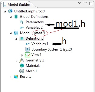

                                                    Salut Naveed
If you have defined your variable or your parameter under Global Definitions, you have to type the Model Identifier before h (mod1.h).
If you have defined h under Model 1, then I don't know what to tell you.
look at the attached jpg.
                            Salut Naveed

                                                    Thank you very much! Yes, it was missing "mod1". I have never done this in COMSOL 3.5a, so a new thing to learn.
