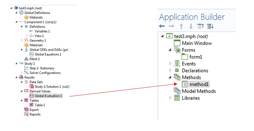

Hello, I would like to get an evaluated value by the « global evaluation », in the “results” section, into a variable defined in the application builder, section “methods”.
Please see the atatched image.
My purpose is to store it as a « double ». That why I defined the variable, here called “test”, as: double test = It rises a type conflict if I try this written. double test = model.result().numerical("gev1");
Is someone have any idea how to write it correctly? Thanks,
Regards, Bertrand

Hi Bertrand, you need to use the folllowing:
The reason for this, is that the Global Evaluation feature can return two dimensional arrays if you have parametric sweeps or a time dependent model, so the method will get the first value.
See the COMSOL Programming Reference Manual for more information.
