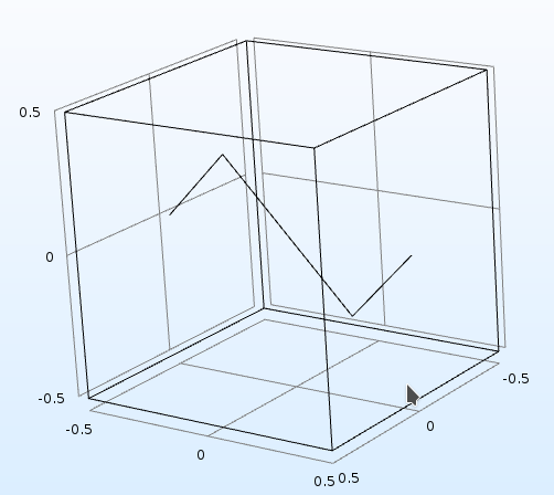

Hello, I have a problem running a very simple magnetic problem with a periodic boundary condition. The file is attached. The unit cell is a cube, I use an edge current as the excitation, which is entering and exiting the domain at the periodic boundary condition surfaces at an angle. I get the following error: Internal error in solve stage of Auxiliary space Maxwell Solver. - Detail: HYPRE error description: Generic error. - Feature: Stationary Solver 1 (sol1/s1)
I am not sure I am applying the periodic bc correctly. I may also have overlooked something else. The file also has an extended, 3D coil domain (disabled currently), and the necessary Coil Geometry Analysis study step. If the "edge current" problem is solved above, I am wondering how this problem could be solved. I am specifying an input and output boundary for the coil, which lies in the plane of the periodic BC. However, the coil is entering at an angle. Would this be handled correctly?
