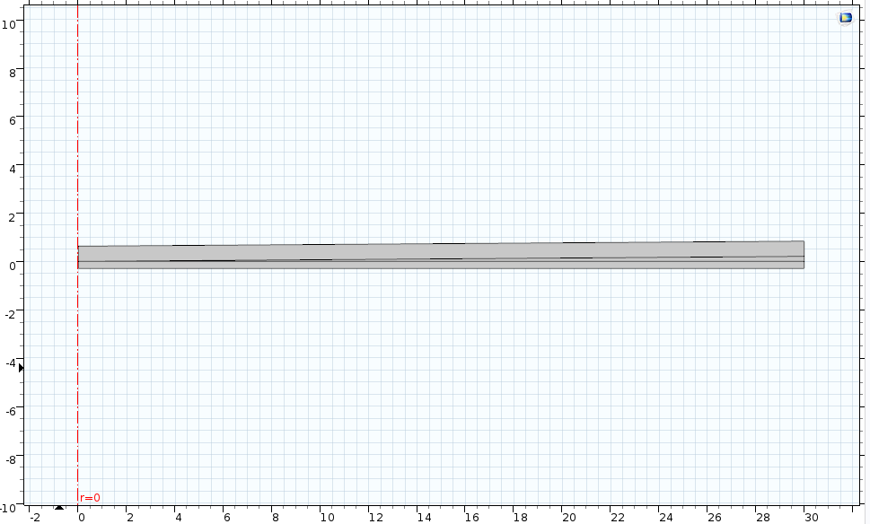

To model this collapse, I implement a contact region in the geometry. The geometry is created with a 2D axisymetric model. The first file attached (see "Contact.PNG") describes the geometry used. I parametered the contact region. Regarding the physics, I used Electrostatics (es), Solid Mechanics (solid) and Moving Mesh (ale) to simulate a fixed, grounded membrane, attracting another membrane (already collapsed), which has a high potential. I also use the muliphysic effect Piezoelectic effect (pze).

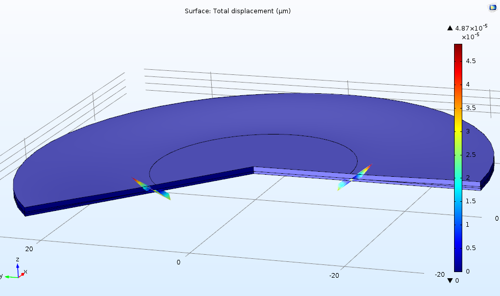

My problem is that when I try to simulate the displacement of the membranes due to the electrostatic force, COMSOL gives me very odd results, actually out of the meshing area (see "Collapsed_displacement.PNG"). In this situations, only the "ring" (thinking 3D) not touching the lower membrane should be able to move. I'm far from being a pro with this software, so I don't have a clue about whats going on.
