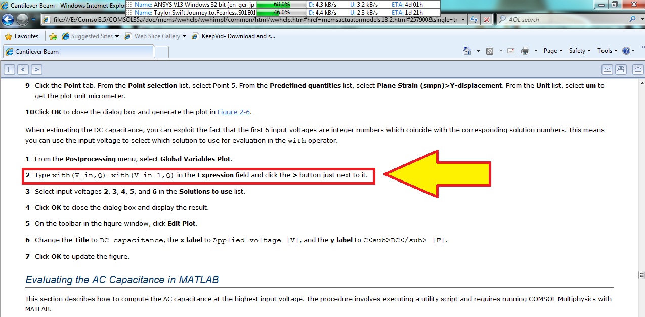

Yes I've checked it and I was trying to repeat all the instructions in the documentation [documentation for simulation of a mems cantilever] but in postprocessing part where the capacitance is calculated I cannot get the plot described in the documentation instead comsol says that it cannot understand the "with operator"
the documentation is attached.
Please help me with this.
Also i cannot find anything about that "with" operator too, please give me a reference for finding information about it or ...

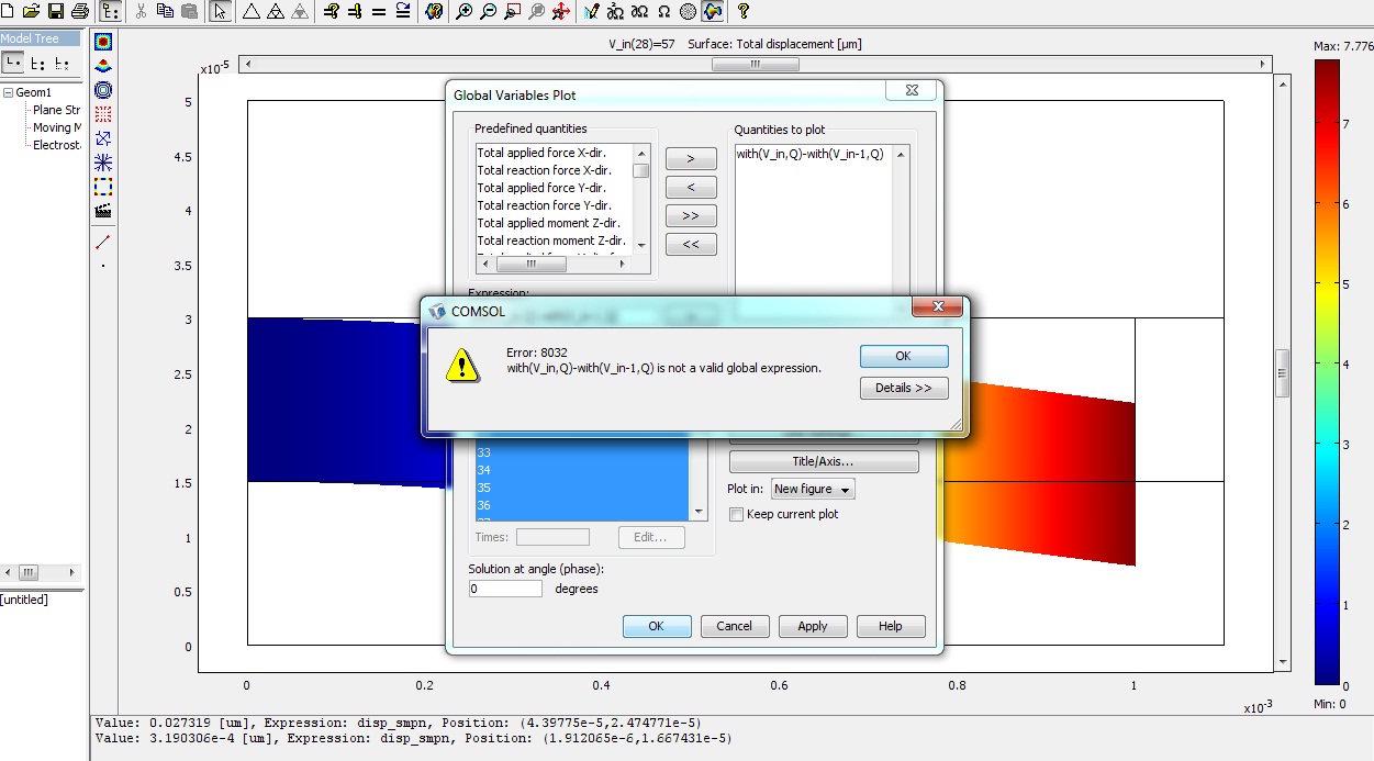

but why when I want to calculate the value it gives me :
Error 8032
with(V_in,Q)-with(V_in-1,Q) is not a valid global expression
i also attach the picture.
Thank you very much for your help
