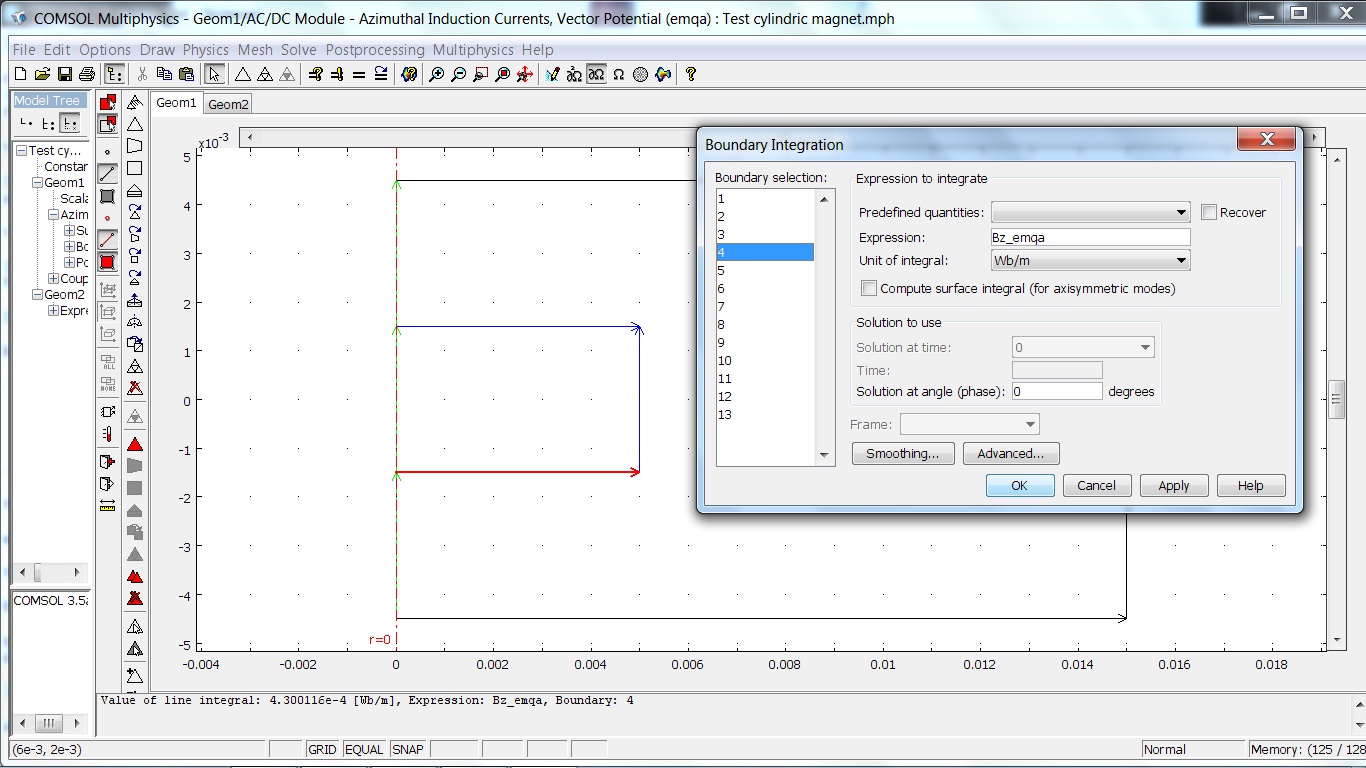

CASE A : If I just select go to POSTPROCESSING> BOUNDARY INTEGRATION> AND I SELECT ONE BOUNDARY OF THE MAGNET I GET THIS RESULT (SEE PICTURE 1 IN THE ATTACHMENT)
"Value of line integral: 4.300116e-4 [Wb/m], Expression: Bz_emqa, Boundary: 4
and if I multiply this by 2*pi *0.005m (the radius of the permanent magnet edge) I get
1.350921284e-5 [Wb]

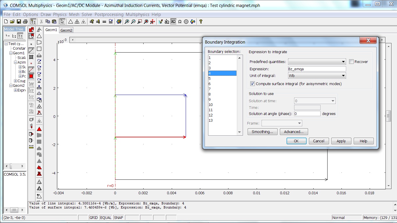

CASE B: If I select the "compute surface integrals (for axisymmetric modes)" then I get.
7.460459e-6 [Wb] (SEE PICTURE 2 IN THE ATTACHMENT)

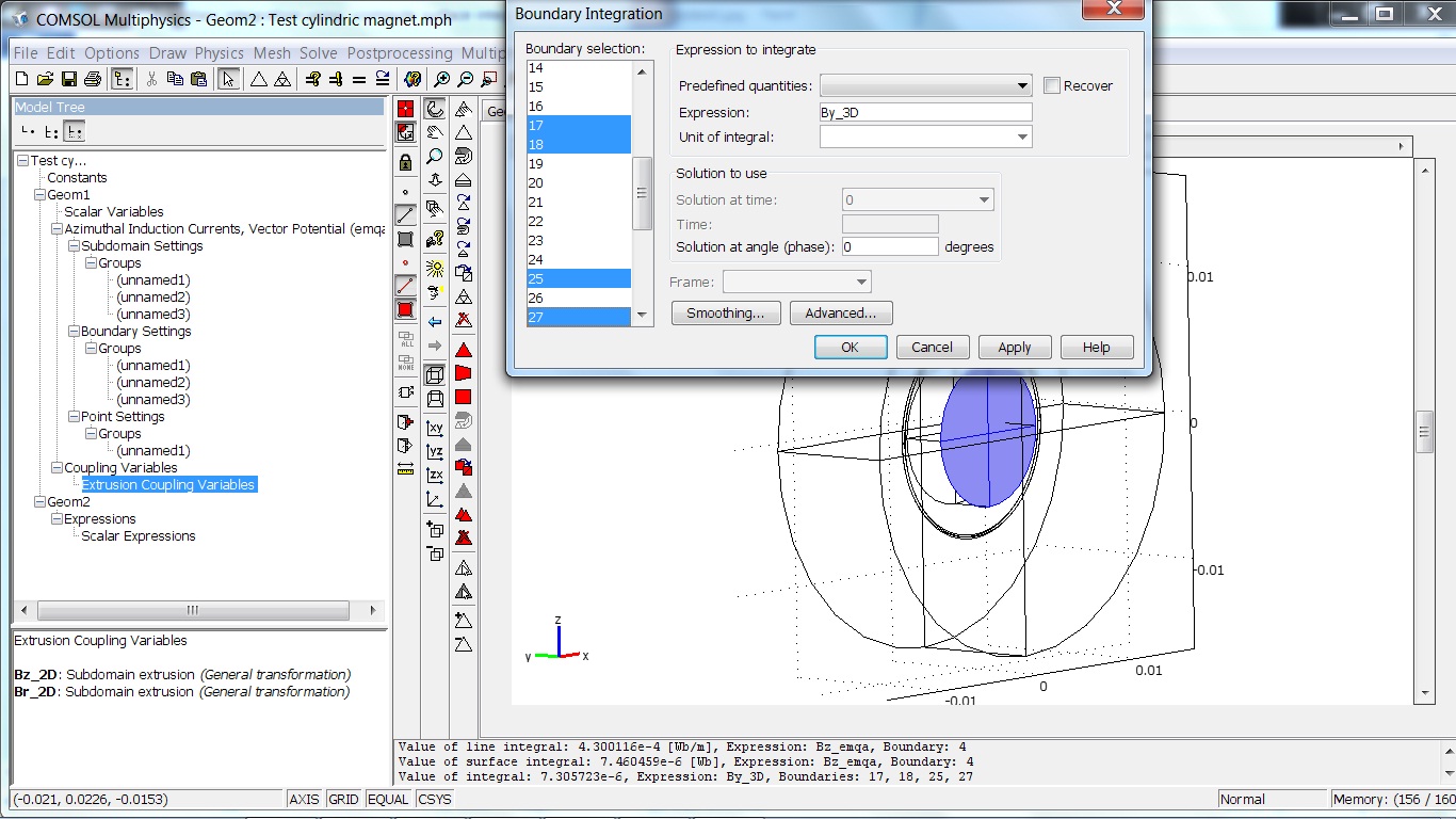

Because this results which I understand should yield the same answer are different, I used OPTIONS>EXTRUSION COUPLING VARIABLES>SUBDOMAIN VARIABLES and get the 3D representation of my 2D axisymmetric model (where By_3D is equivalent to Bz_emqa in 2D axisymmetric mode).
In this integration I obtained
7.305723e-6 [Wb] (SEE PICTURE 3 IN THE ATTACHMENT)
which is also different. Which of these 3 values for the magnetic flux through one end of the magnet (integration of the perpendicular component of B over the cross-section area) is correct?
