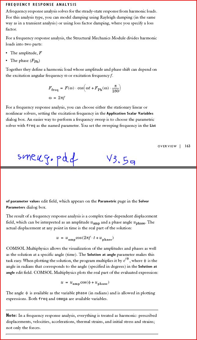

Now concerning the phase, I might not fully understand what you are searching, but you can find how the "phase" is linked in here in COMSOL , i.e. in the smeug.pdf file (an excerb is attached below), or in the knowledgbase:
www.comsol.com/support/knowledgebase/878/
www.comsol.com/support/knowledgebase/1009/
these are more related to AC/DC but they also apply by similiriaty to structural
Hi I can do little with the cryptic error messages of COMSOL, the best is to get their help there. The only I have noticed is that the "fl" introduction to function names stands for original "Femlab" code, and what is written below you had an "get-array" 'int32' cast error when attempting to access parts of "fem.sol.u". Now concerning the phase, I might not fully understand what you are searching, but you can find how the "phase" is linked in here in COMSOL , i.e. in the smeug.pdf file (an excerb is attached below), or in the knowledgbase: http://www.comsol.com/support/knowledgebase/878/ http://www.comsol.com/support/knowledgebase/1009/ these are more related to AC/DC but they also apply by similiriaty to structural Good luck Ivar
