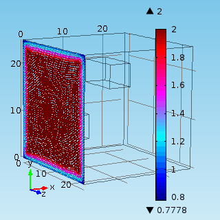

Your model seems to work for me as well. I've attached an animated GIF of the particle flow that I see.
